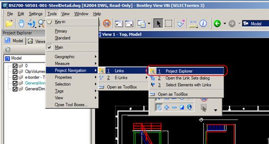

Option 1:

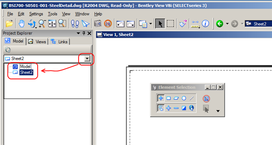

Models, sheet models can be changed using the Project Explorer. This dialog contains controls to manage all the data in the model, such as levels and references.
Using Project Explorer dialog:
1. If Project Explorer dialog is not opened: go to drop down menu Tools->Project Navigation->Links->Project Explorer
2. In Project Explorer dialog under Models tab the models/sheets can be chosen.

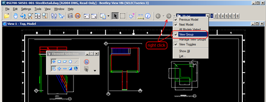

Option 2:

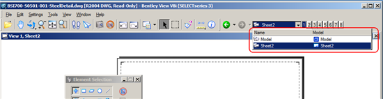

Other option switching between models, sheet models is using the View Groups dialog. By default the view groups icon is hidden:
1. Right mouse click on any icon/tool in View Groups dialog
2. Turn on display of “View Groups” tool
3. Now the models/sheets can be selected from the list
