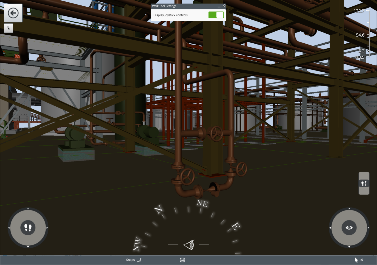

If you have a touch display or mobile device, you can use the joystick controls instead of dragging your mouse or finger in the view. All you need to do is turn on the option from the Tool Settings. For Navigator Mobile the joysticks are displayed automatically.
| The left joystick moves the camera. | |
| The right joystick allows you to look around. | |
| The elevation control allows you to move vertically up and down like you are in an elevator. |
There are several on-screen display aids to help orient yourself in the model.
| Displays your elevation within the model. Your current elevation is shown by the caret on the elevation bar. | |
| Shows your current view pitch. |
