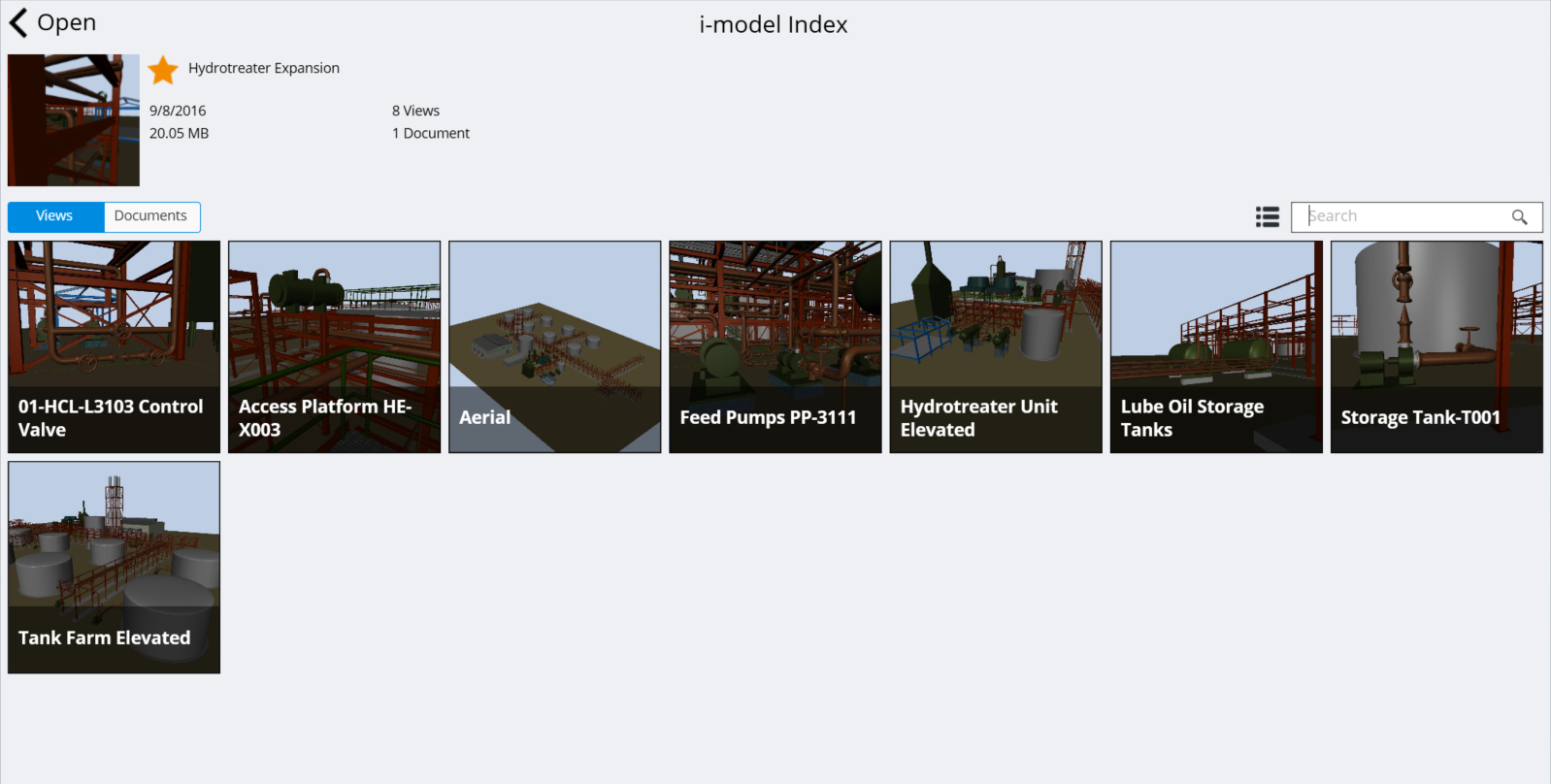

i-model Index screen
The i-model Index screen shows the list of saved views stored in the i-model as well as any saved views you created. The i-model Index screen appears after you select a file or when you are in a model. You can access the i-model Index from the Backstage panel.
Note: Selecting saved views from the i-model Index opens to that view. This means any categories, models, items or appearance overrides are reset and the view appears as it looked when created.

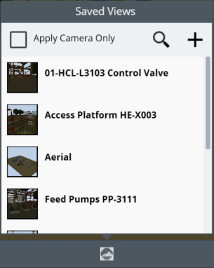

Saved View Tab
The Saved View tab gives you the ability to apply views as well as to create new views that you can recall later. Views display as thumbnails sorted alphabetically. You can filter the list by selecting the search icon and using the search bar that displays.
Saved views that you have created can be updated, deleted, or shared from the More Actions  button which displays to the right of saved views in the list in the Saved View tab. When a saved view is shared, the Shared  icon displays next to the saved view name. Shared saved views can be synced with other members of your CONNECT project by selecting the Sync button from the Backstage Panel.
Note: The More Actions button only displays for saved views that you have created.
When you select a view from the Saved View tab, the model view moves the camera and changes the display of categories and models. If you do not want the categories and models changed, enable the "Apply Camera Only" toggle in the tool bar.
Note: If you have hidden, isolated or changed the display of items, they are not changed when you apply the saved view.
To create a saved view, just navigate to the point of interest and select the add icon in the tool bar of the Saved View tab. You are asked to provide a name for the saved view and the saved view is created.
Note: Only saved views that you have created can be deleted.
