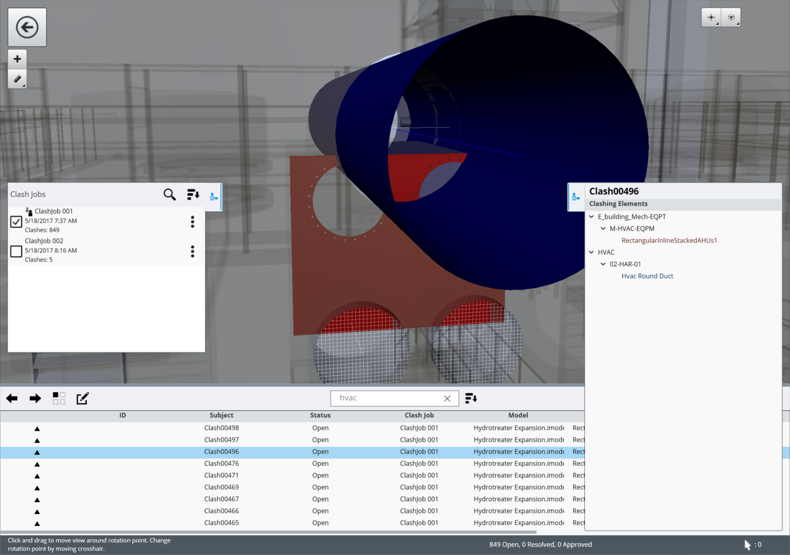

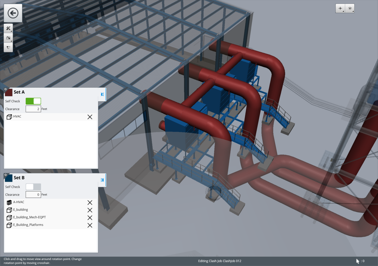

Clash detection allows you to check for interferences between items in the model and share these issues with other project participants. This ensures that different engineering disciplines can work together and construction can occur without coordination problems. Clash Detection is broken into two phases. The first phase is defining what to test against. The second phase is viewing the results after the job is processed. You also can set up suppression rules to filter out clashes you do not want to see.
