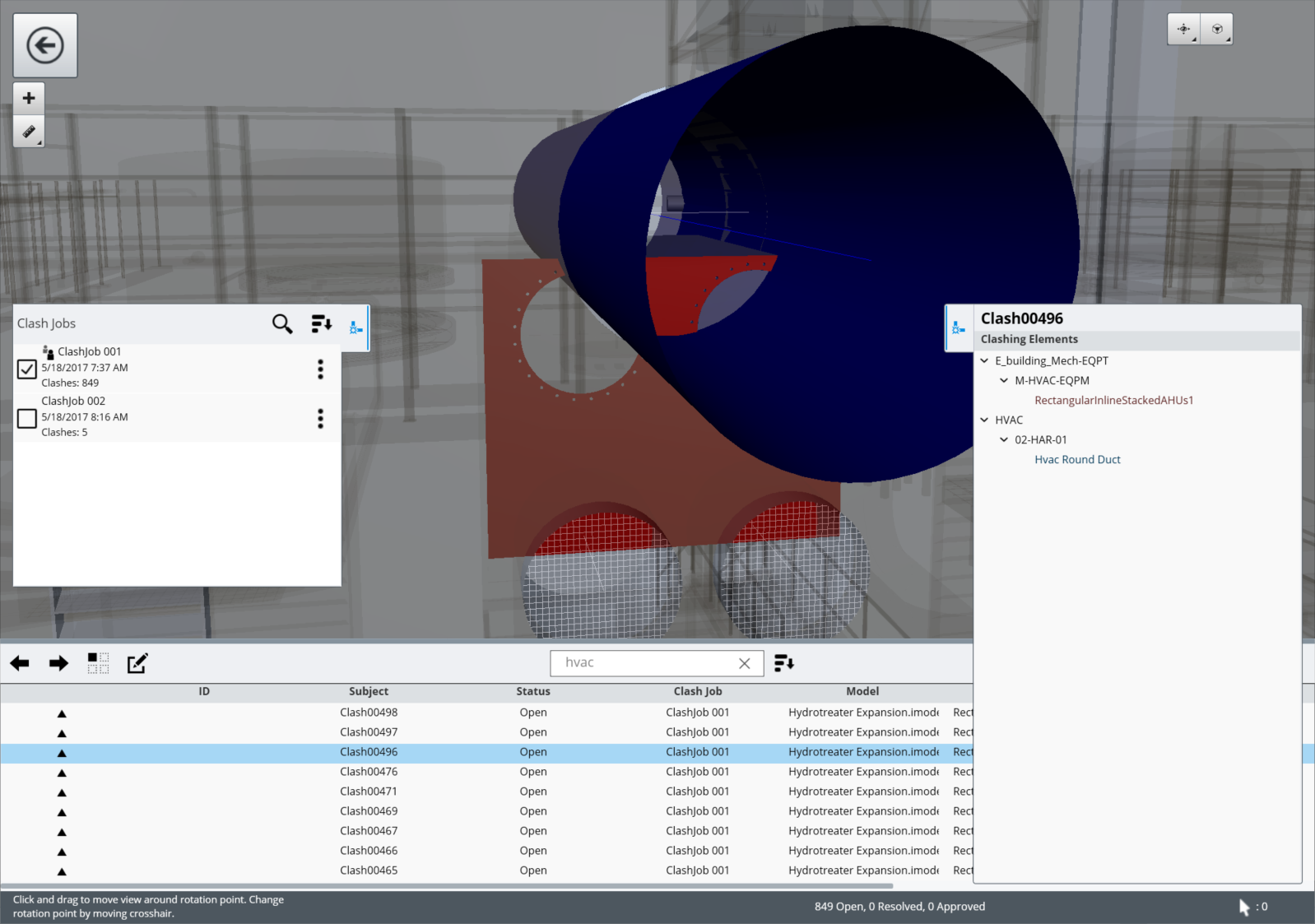

To view the clashes for a processed clash job, first make sure the clash job is enabled. A checkmark displays next to enabled clash job names in the Clash Jobs tab. If the checkmark does not display, select the clash job name to enable the clash job. The clashes for all enabled clash jobs display in the clash list on the bottom edge of the screen. Each clash issue has a set of editable fields, and may contain redlines, attachments, and comments. From the toolbar of the clash list, you can search the clash list or select the Sort icon to select how you want to sort the clashes. You can also move through the clash results one at a time by using the forward  and back  icons. To view a clash result by itself in the view, select the Isolate Clash Result  icon. You can select any row in the list which also selects the associated items in the view, zooms to the items, and opens the Clash Properties tab in the File Browser zone from the middle right, where you can see the location of the items in the model hierarchy. Selecting an element of the model hierarchy displays information about that element in the Properties zone in the bottom left.

A newly-created or edited clash result displays a triangle  in the first column which means that this clash result has local changes that need to be synchronized. a newly-created clash result gets a unique ID number defined by the project.

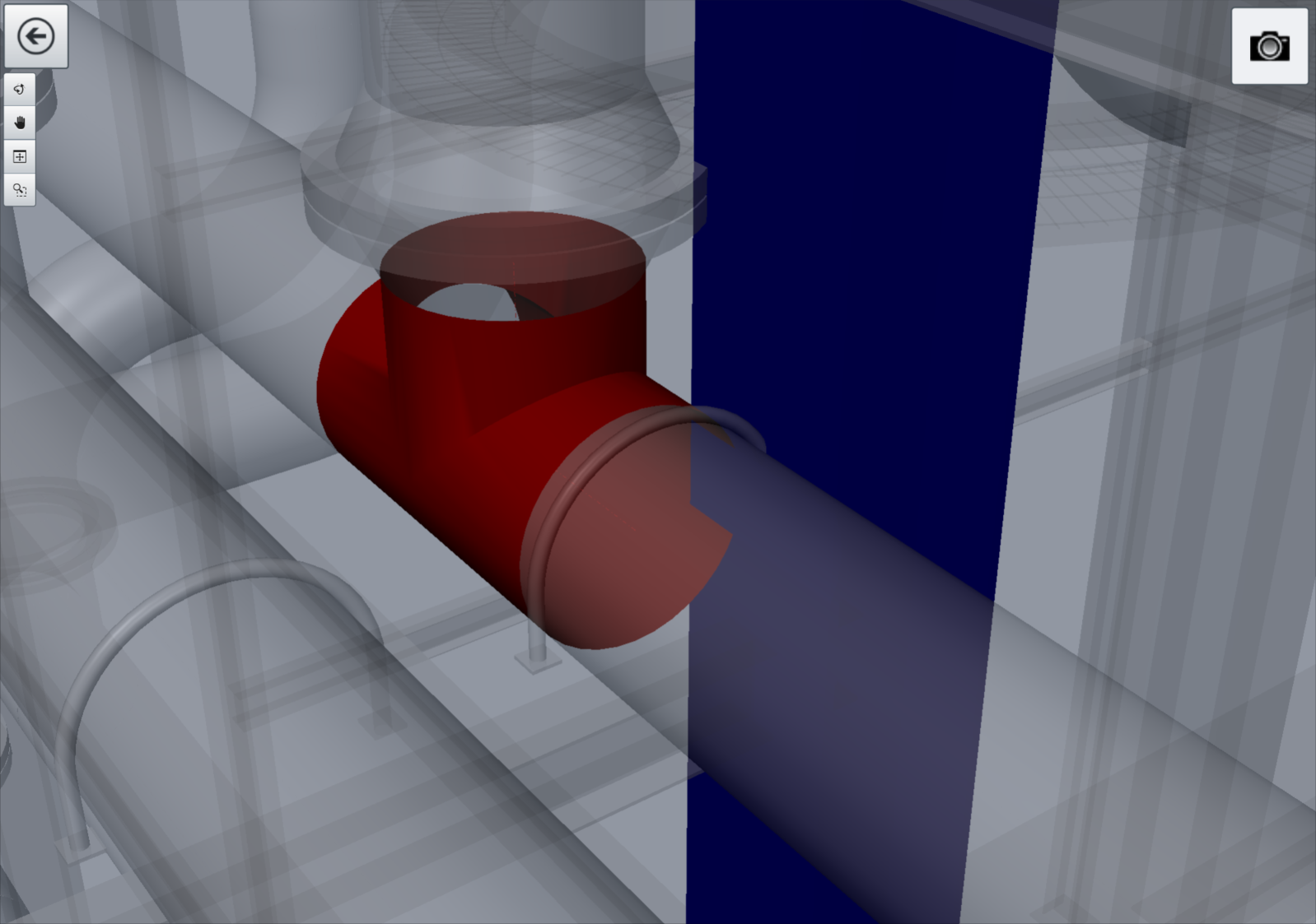

From the Attachments tab select the Add "+" button. The Capture Screen mode opens. When creating a screen capture of the view, first you need to orient the view for the capture. While in the Capture Screen mode, you can orient the view by using standard mouse and gesture controls or by using the tools in the Tools Menu.  Once the view is oriented the way you want it, select the Capture button  in the upper right. Selecting the Back button in the Tools Menu takes you back to the Edit issue dialog.

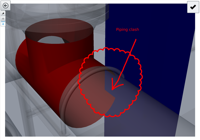

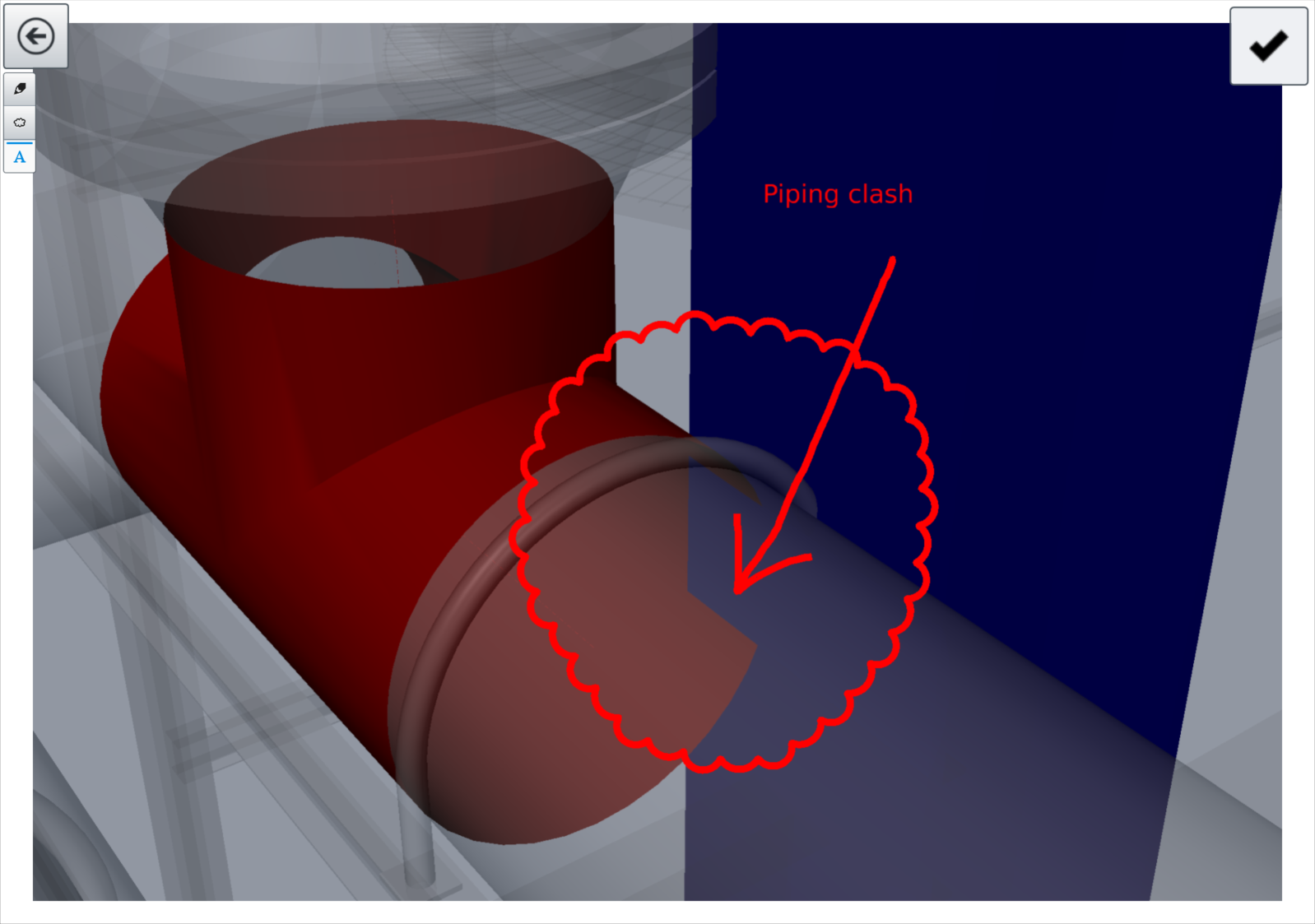

Once the view is captured, the Annotate Attachment screen opens. Here you can add redlines to the attachment before saving it. From the Tools Menu you can choose to draw free hand shapes, clouds or add text to the attachment. Selecting the Back button takes you back to the Capture Screen mode.  Once you have made your annotations, select the Save button (checkmark icon) in the upper right to add the attachment to the clash issue.
Note: Attachments can be added to a clash issue at any time but you cannot edit or delete an existing attachment.
