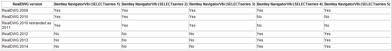

Following table lists the support of RealDWG in different versions of Bentley Navigator:

Bentley Navigator V8i (SELECTseries 5) delivers RealDWG 2009 and RealDWG 2014. By default, RealDWG 2014 is active. RealDWG 2010 and RealDWG 2011 are not supported in Bentley Navigator V8i (SELECTseries 5). If you have RealDWG 2010 installed on your machine, it will not work with Bentley Navigator V8i (SELECTseries 5).
If required, you can use RealDWG 2009, RealDWG 2012, or RealDWG 2013 instead of RealDWG 2014. For example, you may have multiple V8i (SELECTseries 3) products installed and you need to use RealDWG 2009 with one of the products.; or you may discover that a 2014 version of an object enabler that you need is not available, therefore you need to use RealDWG 2009.
You can add the MS_REALDWG_VERSION configuration variable and use it to revert to RealDWG 2009, RealDWG 2012, or RealDWG 2013. This configuration variable can be used to switch back to RealDWG 2014 as well.
