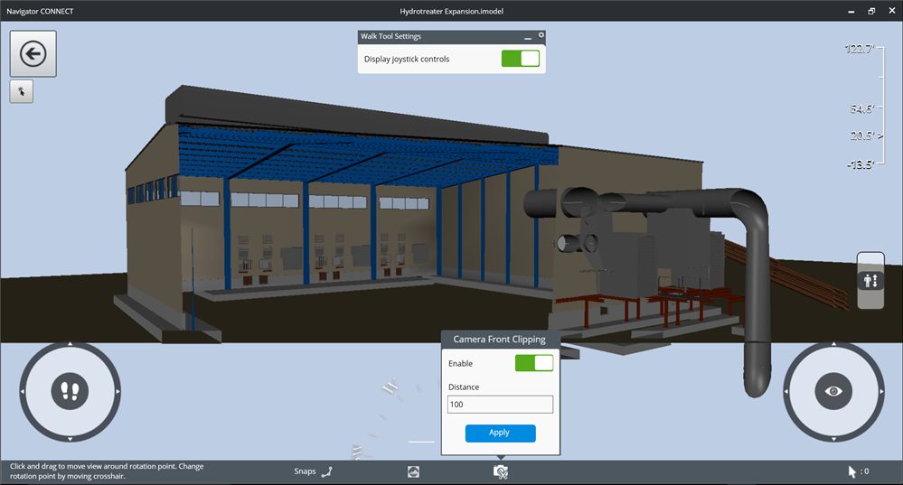

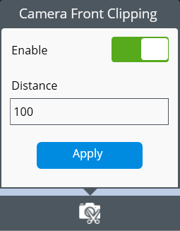

To turn on camera front clipping, select the camera front clipping  icon from the Status Bar on the bottom edge. From the Camera Front Clipping tab that displays, turn on the Enable toggle. In the Distance field, enter the distance where you would like objects to be clipped. This distance is measured in the display units which are chosen on the Settings page.

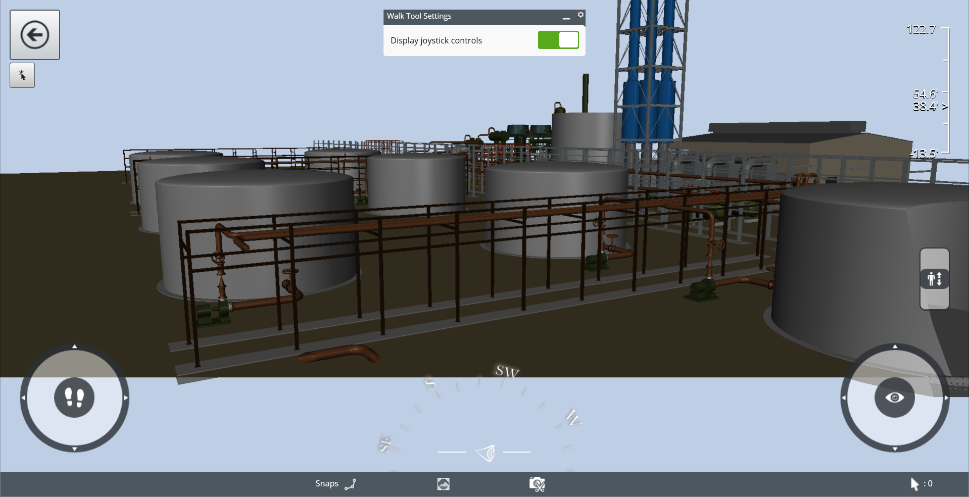

In the following screenshot, the tank closest to the camera is outside of the Front Camera Clipping distance. Therefore, the tank displays fully.

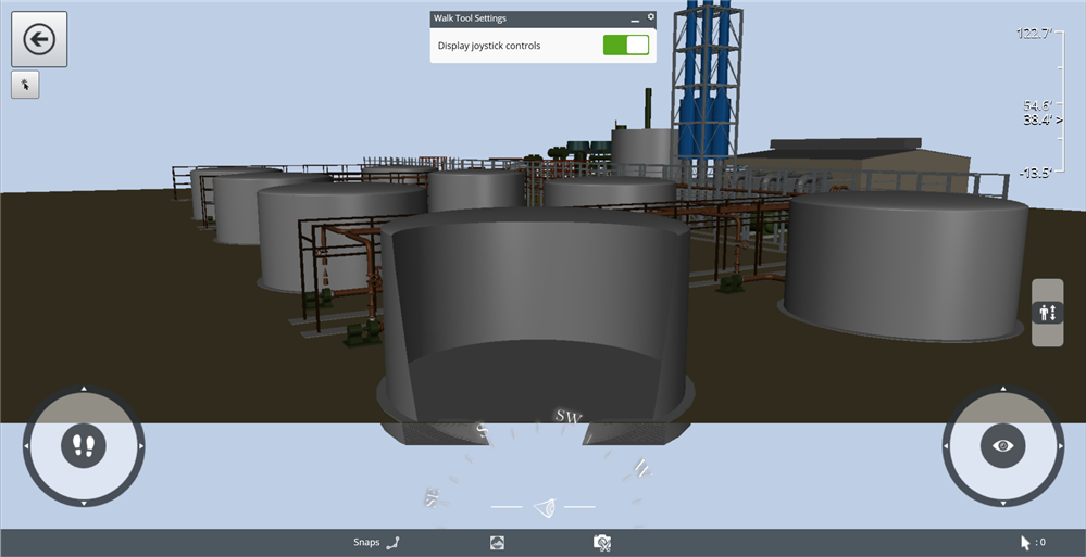

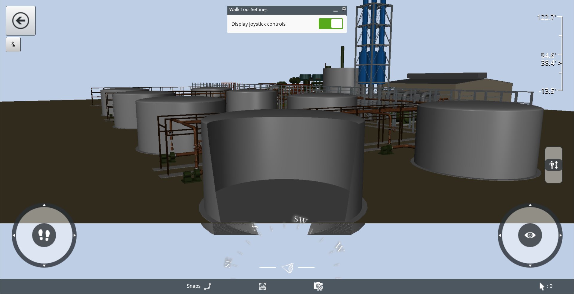

In the following screenshot, the tank closest to the camera is partly inside of the Front Camera Clipping distance and partly outside of the distance. Therefore, the nearest part of the tank does not display, and the inside of the tank is visible.

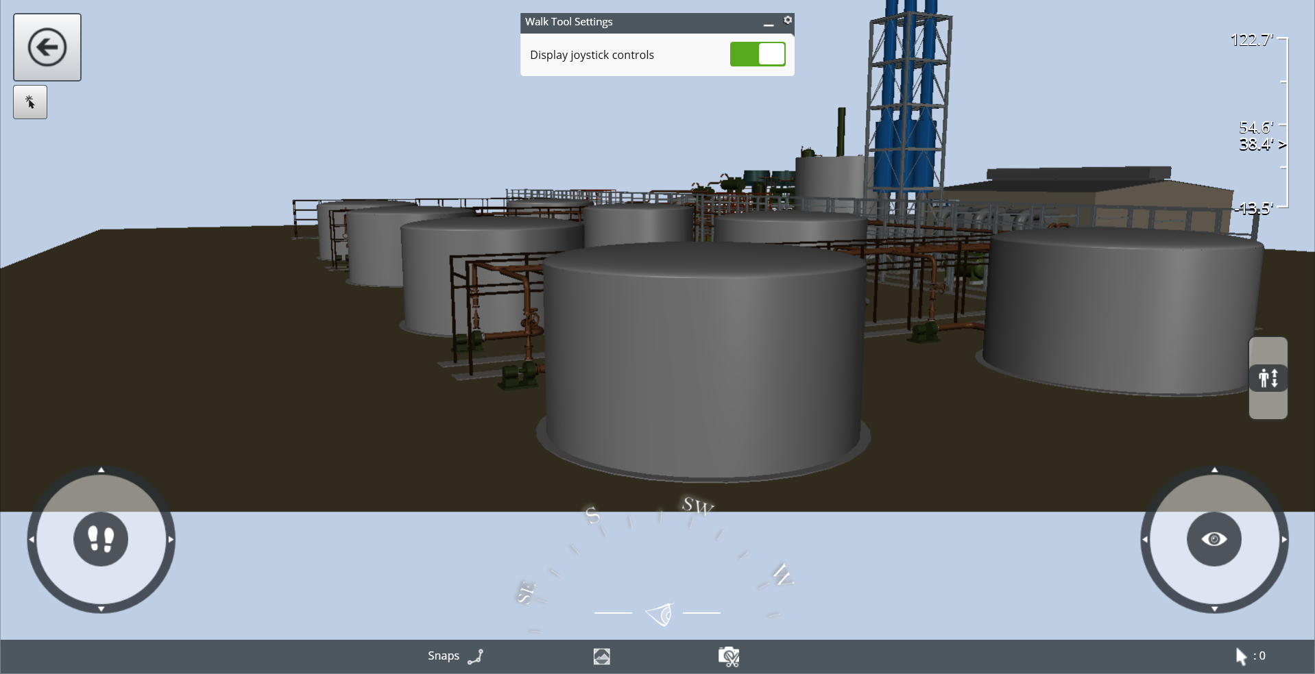

In the following screenshot, the whole tank is within the Front Camera Clipping distance. Therefore, the tank does not display.
