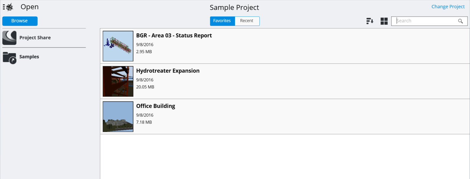

File Open Screen
The Open screen makes it easy to find an i-model or to quickly access commonly used i-models. The first step in organizing files is to select the appropriate CONNECT project. Do this by clicking the Projects dropdown in the upper-left corner. Each project maintains its own list of recent or favorite i-models.
Depending on the project you select, you can access i-models from the iModelHub, ProjectWise Share or ProjectWise Connection.
  • iModelHub lets you access i-models shared for your active project on the iModelHub.  The iModelHub cloud service is a change management and notification service. The iModelHub logs all project changes on a timeline, and then notifies project participants based on their ProjectWise workflow configuration. It provides an accountable record of who did what, and when. Any version of I-model can be accessed, and significant versions can be named. Visual and textual reports can show the difference between any two points on the timeline.
  • ProjectWise Share lets you access I-models shared for your active project. All model files shared in the CONNECT project display here. With ProjectWise Share, you can securely share files among desktop or mobile devices for greater project collaboration. See ProjectWise Share.
  • ProjectWise Connection lets you directly access I-models that are stored in ProjectWise. To create a connection to a server, see ProjectWise Connection. The ProjectWise Connection extends the ProjectWise Share capabilities with federated access to Office 365 SharePoint document libraries, enabling simple and fast access to a wider set of project information.
Note: To create a connection, you first need to install and configure the Bentley Web Services Gateway.

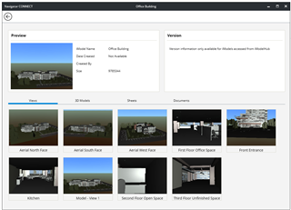

i-model Index Screen
An i-model is a package that contains a model as well as related documentation. The i-model Index screen makes it easy to either enter into the model using a saved view or view the embedded documents in the i-model. On this screen, you can set an i-model as a favorite, which adds it to your Favorites list and stores it on your device for offline use.
Switching between Views and Documents allows you to select a point of interest when opening the model or a document embedded in the i-model.  For documents, the application associated with the file type launches so that you can view the document. From the Sheets tab, you can select any sheet model that is included in the i-model and view that sheet in Navigator.
Click the star icon to set the i-model as a favorite. When you set an i-model as a favorite, it downloads the file and makes it available for offline use. It also appears in the favorite list on the File Open screen.
Note: If you would like to bypass this screen and go directly into the model, change the Open File Directly option in the Settings screen.
