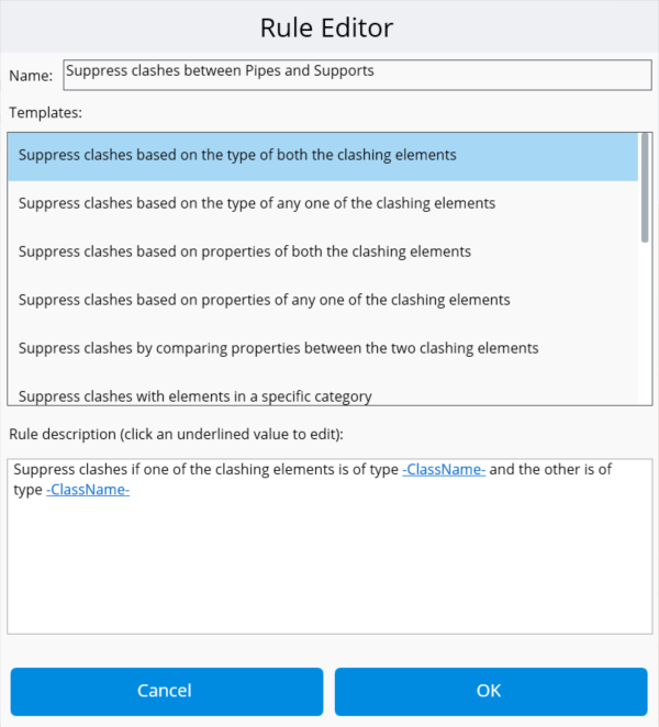

To add suppression rules to the clash job, select the Edit suppression tool.
To create a new suppression rule, click Create a new suppression  on the Rules dialog. In the Rule Editor dialog, give the rule a name. The rules are named Rule 00n in sequential order.
In the Templates list, click the rule you want to apply. In the Rule description box, click the underlined value. In the dialog that opens, either make your selection from a drop down list or enter a value, then click Apply. When finished editing the rules, click OK in the Rule Editor and close the Rules dialog.
