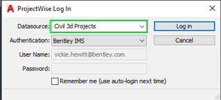

2.  Login to ProjectWise

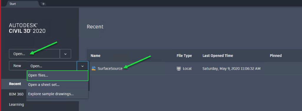

3.  Open a File from the Start Page
You can Select Open Files or a Recent Document.
If the recent document was opened from ProjectWise it will open from ProjectWise
Open Files will Open the ProjectWise “Open Document” Dialog

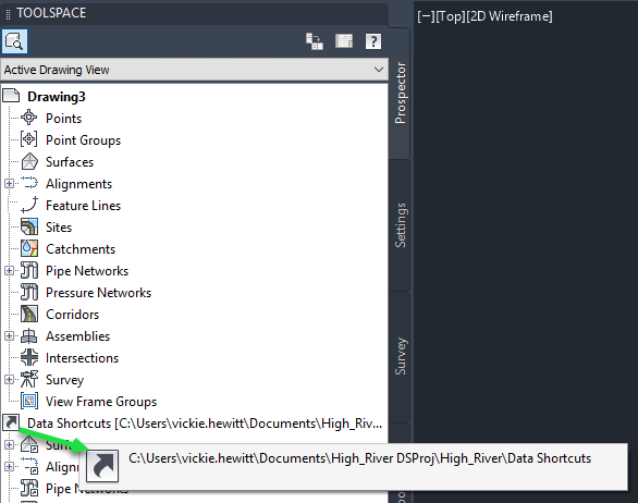

Notice that the Toolspace typically opens prepopulated with the last working folder that you set.

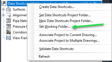

3.  In the Toolspace, right-click the Data Shortcuts and select Set Working Folder

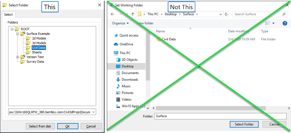

4.  Navigate to the Civil 3D Working Folder for the data shortcut project and select OK
After you hit Ok, you should see the data shortcut path.
If no path is displayed in between the brackets next to Data Shortcuts you may need to reset the Project Folder.

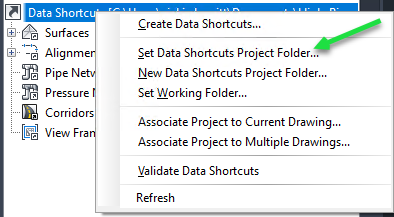

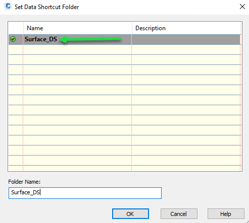

5.  Right click on Data Shortcuts and select Set Data Shortcuts Project Folder.
6.  Then select the data shortcut project you want to use.

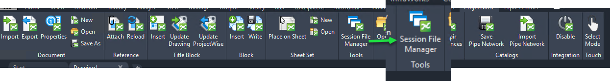

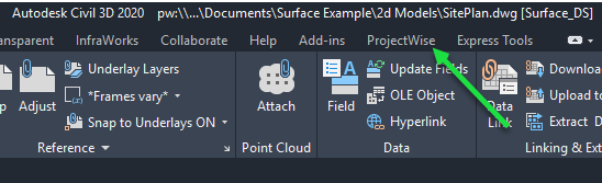

1.  Open the ProjectWise Ribbon

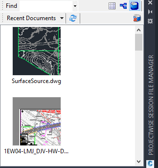

2.  Open the ProjectWise Session File Manager from the ProjectWise Ribbon
The dialog opens showing thumbnails of your recently used files.
3.  Select a file to open it.

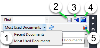

4.  The controls for the Session File Manager dialog are at the top.
Working in Reference View
Toggling between Session and Reference view changes from a flat structure (Session) to the Tree Structure (Reference).

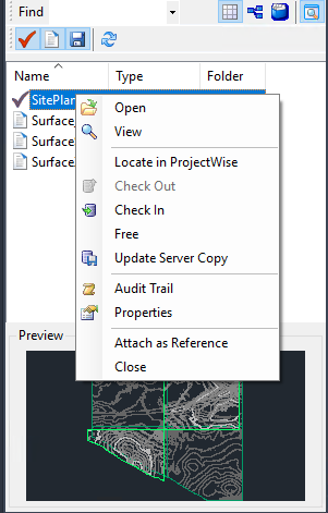

1.  Select Reference Mode and right click on a file.
The commands in this menu correspond to the same commands as in PW. Highlighting a few of the most useful here.
· Open - will open the file to a new tab.
· Update Server Copy – will allow you to send your changes to the server after a save, so that other users can also see it.
· Properties – will allow you to fill out the file attributes that you can use in your titleblock.
