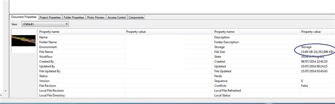

Document Properties displaying incorrect units
 Product(s):ProjectWise Web Server Client
 Version(s):08.11.11.574
 Environment: Windows 7 (x64), Windows 7 (x86)
 Area: GUI
 Original Author:Steve Boniwell, Bentley Technical Support Group

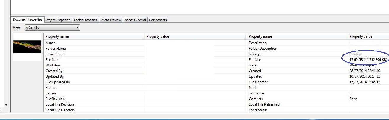

When viewing the properties of a document in the Document Properties windows in ProjectWise Explorer, the File Size was displayed as GB rather than MB

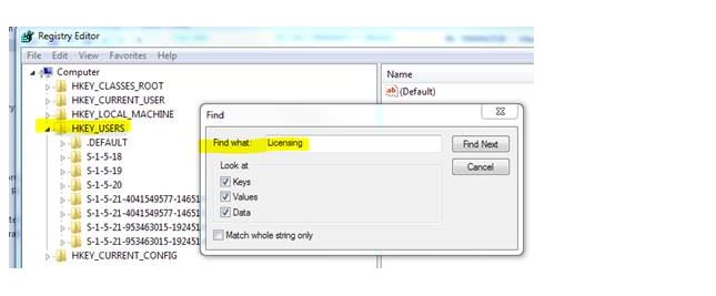

This is typically caused when a previous version of ProjectWise Explorer has been removed but there are old resource files left behind. These can cause a conflict with the new version resulting in this issue.

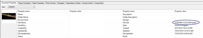

Performing an uninstall of ProjectWise Explorer, removing the installation folder
(C:\Program Files (x86)\Bentley\ProjectWise\), rebooting and then reinstalling ProjectWise Explorer addressed the issue.
