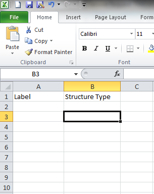

2) Create an Excel spreadsheet and title one column 'Label' this will let you identify the elements that you're importing
3) Any other columns that you add should contain the name of the property as it's listed in the software that you're interested in learning more about the data type. For example, you might another column header for 'Structure Type' if you want to see the type of input Modelbuilder needs in order to define a manhole as circular structure, box structure, or transition structure. Save the Excel spreadsheet and close it after you've finished.

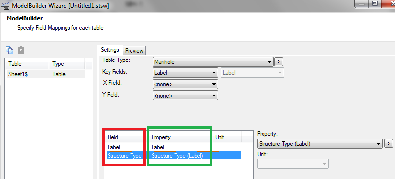

5) Open Modelbuilder (Tools > Modelbuilder) and create a new run. Select the correct Excel datasource type and then browse out to locate your file. Skip to the field mapping step of Modelbuilder, step 5,  as shown below. Map the fields in the green square to their names in the red square.  The data in the red square are the columns that are being read from your Excel sheet and the data in the green square are the properties in SewerGEMS that you're going to be matching to these columns to populate the sheet after you sync the data out. After you're done with this click the "Next" button on the bottom right to proceed.

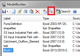

7) On the main window for Modelbuilder make sure you have the row you're exporting highlighted in blue by single clicking on it and the click the "Sync Out" icon, which is highlighted by a red box in the screen shot below.

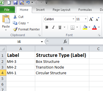

8) Finally open your Excel spreadsheet and you can see the data type the field needs to be, as well as, how to enter the values you want to import.
