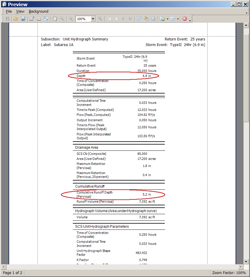

How can I view how much rain was not converted to runoff? (how much "loss") Can I view the infiltration on a per catchment basis in a report?
The amount of that water that flows off the catchment and into your system depends on the SCS CN (curve number) that you enter, which is a function of the type of land and how porous it is, etc.
If you want to compare the rain depth to the depth of runoff, you can compare the rain depth value to the Cumulative Runoff Depth value, which you can see in the Unit Hydrograph Summary report in Report Builder. You can also get this value under the "Results" section of the properties of the catchment.
