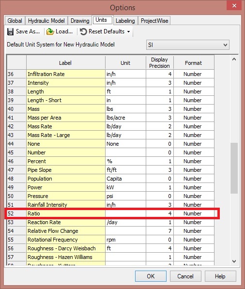

The values for the R and K coefficients in the RTK files have a display precision of three digits after the decimal point. Is there a way to change this in the model?
Problem ID#: 71745
The display precision for the time (T) portion of the RTK table can be changed directly in the RTK table itself. However, to change the R and K coefficients, open the Options dialog and choose the Units tab.
Find "Ratio" in the Label column and change the Display Precision to the value you want. When you return to your RTK data, you should see the new number of digits after the decimal point.
