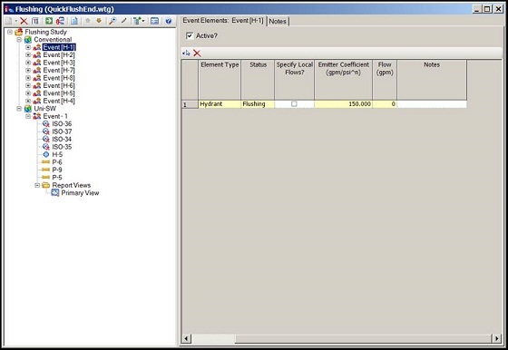

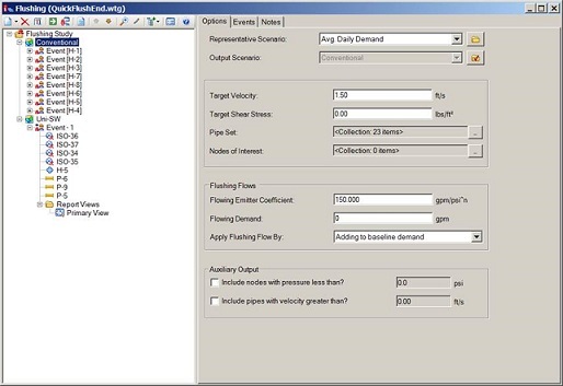

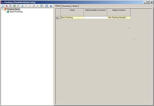

To perform an analysis of a set of flushing events (i.e. a flushing area), the user must create flushing events.  Upon opening the flushing manager initially, there will be a default study, "Flushing Study" which will have one area called "Base Flushing" in the left pane.
The user creates new studies or areas by right-clicking on the study node in the left pane.  By right-clicking on the area a new event can be created.
Identifying the Buttons Left to Right
Within a flushing area, the user defines the representative scenario, target velocity and shear stress, pipe set, method to determine flow (emitter or flow) and auxiliary output if desired.  It is a good idea to create a selection set corresponding to the pipe set before entering the flushing manager.
The user then creates events within an area.  It is assumed that the flushing events are conducted in the order in which they are listed.  The key to order is usually to flush from clean water into un-cleaned areas.
Conventional events are made up of the hydrant (or junction) to be flowed.  These events have an advantage of being very easy to set up a large number of conventional events in essentially one step.  The user will see the Selection dialog where individual junctions or hydrants are selected.  Junctions or hydrants can be selected by polygon or they can be selected based on a selection set that has been previously defined.  If not all the nodes in a polygon are to be flowed, it can be helpful to have a selection set done already.

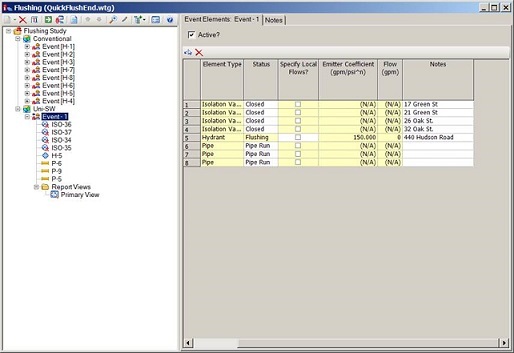

For UDF events, they must be created one at a time because the user must select flowed elements, controlled elements, and optionally the pipe run to be flushed.  In this case a special form of the select dialog is opened.
The events tab enables the user to get a quick view of the events that are contained in the area, and if desired, make events active or inactive for the next run.  The notes tab enables the uwer to enter a text description of the area.
In creating a UDF event, use the second button to select the operational elements (hydrant, junction, valve).  If a hydrant or junction is selected, it is considered to be flowed.  If an isolation valve or control valve is selected these are considered to be closed.  If a pipe element is selected the default is that the pipe is closed.  If the user selects the third button to select the pipes will be a part of the pipe run.
In creating a UDF event, use the third button to add the pipe run elements.
Once an event is created, if the event is expanded in the left pane, there is one row for each element that is flowed, closed, or part of a pipe run.
The element label and type are properties of the element selected and the status is an editable field (unless it is a flushing element such as a hydrant) indicating if the element is open/closed, flowed, or part of a pipe run.  The flow emitter or flows specified in an area tab can be overwritten by checking the Specify Local Flows check box for that element and inserting a different flow or emitter.
Note fields are very important if the results of the flushing analysis are to be given to operators to locate elements to operate.  The notes may included an address for a hydrant or at a location of a valve that needs to be closed.

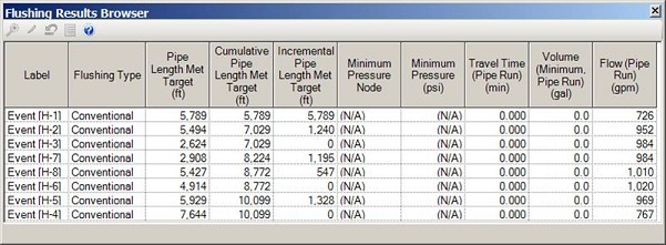

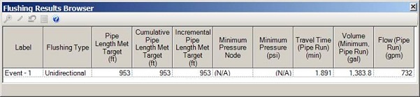

Flushing Results Browser
The flushing results browser contains the results of a flushing run listed by event.  The content of the browser corresponds to the current scenario.  If it is not a flushing output scenario, no events would be displayed.  The scenario can be switched to the flushing browser in the main drawing or by picking the button next to the output scenario selection in the right panel of the flushing manager.
Before opening the browser it is helpful to set up color coding and annotations that will highlight the flushing events.  Usually color coding pipes by velocity or shear stress, and junctions or hydrants by demand, will be the most useful.
Conventional Results

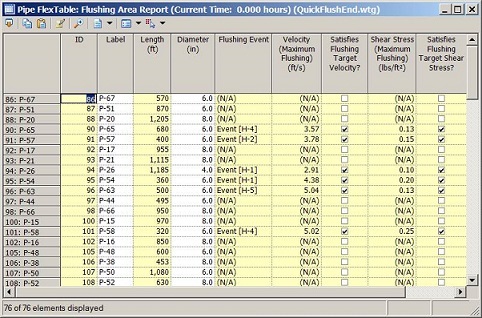

Flushing Area Report (Flex Table)
While the Flushing Results Browser displays flushing results on an event basis, the flushing area results flex table presents the results on a pipe basis listing whether the pipe met the flushing target and which event was the most effective in flushing that pipe.
With the current scenario set to a flushing output scenario, open the flushing flex table.  By default, the table will open with all pipes.  If the model is large it is helpful to make a selection of elements and pick "Open on Selection" when opening the flex table.

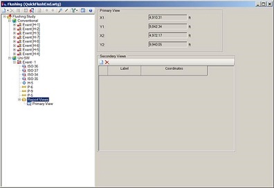

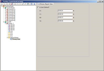

The user can identify the extent of the drawing that will appear in the optional reports.
Default Report Options
User Defined Report Options
Before opening the operator's report button, the modeler should:
1. Set up the desired background layer
2. Decide the extent of the view to display and if additional views are desired, set up those views.
3. Include detailed notes to help the operators locate the elements (e.g. an operator may not know where H-21 is located but will know "Hydrant in front of 31 Elm St.".

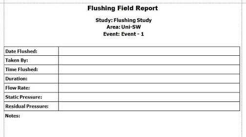

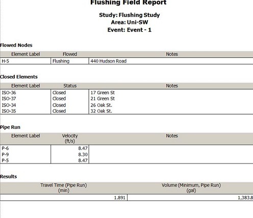

Operator Report
The operator report consists of three types of pages for each event:
1.  Text description of the event indicating which elements to operate
2.  Drawing of the event

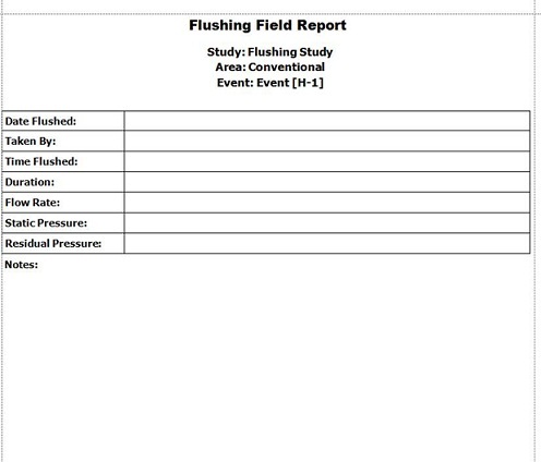

3.  Form which flushing operator can complete to describe results of flushing for feedback (optional).

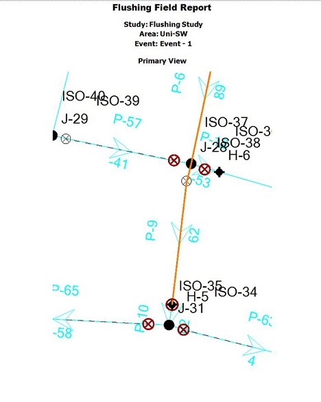

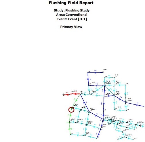

In addition to the default drawing of the event, the user can create "Secondary Views" which may for example, zoom into details of a complex intersection.  To do this, right-click on Report Views in the left pane and select Add Secondary View.  Draw a box around the extents of the secondary view and click Select New Report View.
The view that appears when the report is open is called a Preview.  With this preview, it is possible to:
The report can be saved and it is possible to zoom and pan within the document.
Example of a Conventional Report
Example of a UDF Operator Report
