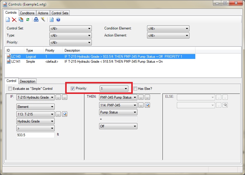

Priorities in Controls
You have the ability to add a priority value to a control. To set a priority for the control being created, it needs to be a logical control. To activate the priority drop-down list, click the checkbox next to Priority.
You can set a priority of 1-5, with 5 being the highest priority. If multiple controls meet a certain condition and they have conflicting actions, the control with the highest priority will be used.
Note:  At calculation time, the priority is used to determine the logical control to apply when multiple controls require that conflicting actions be taken. Logical controls with identical priorities will be prioritized based on the order they appear in the Logical Control Set in the Operational alternative. A rule without a priority value always has a lower priority than one with a value. For two rules with the same priority value, the rule that appears first is given the higher priority.
