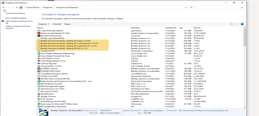

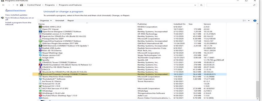

Uninstall the following
  1. Bentley Structural Property Catalog  - Uninstall all the existing Structural Property Catalogs from the Control Panel (as shown in the images below)
