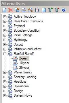

2)      Go to Analysis > Alternatives and expand Rainfall Runoff. If you haven’t done anything with alternatives yet in the model, you should only see the base rainfall runoff alternative.
3)      Rename the base alternative as your first return event, such as 2 year.
4)      At the top of the alternatives manager, click the New button to create a new base rainfall runoff alternative. Name this as your next return event, such as 10 year.
5)      Repeat step 4 until you have all the return events you need.

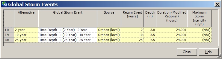

6)      Go to Components > Global Storm Data. This dialog is simply an easy way to associate rainfall curves with rainfall runoff alternatives.
7)      Select the corresponding rainfall curve next to each rainfall runoff alternative

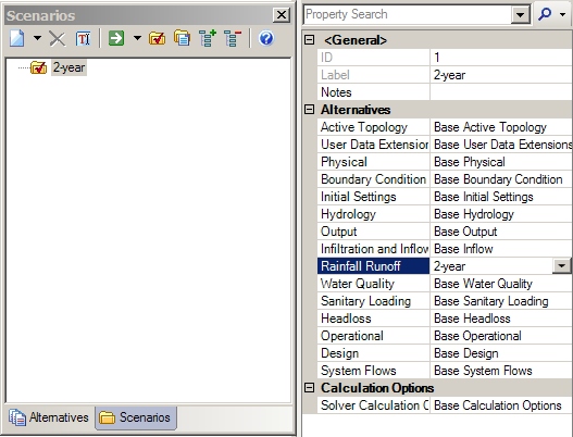

8)      Close this dialog and go to Analysis > Scenarios. By default you will only see a “base” scenario.
9)      Rename the base scenario to reflect the first return event such as 2-year
10)      Double click that scenario and the properties window will appear, showing you the alternatives used by that scenario. Ensure that the 2-year rainfall runoff alternative is selected.

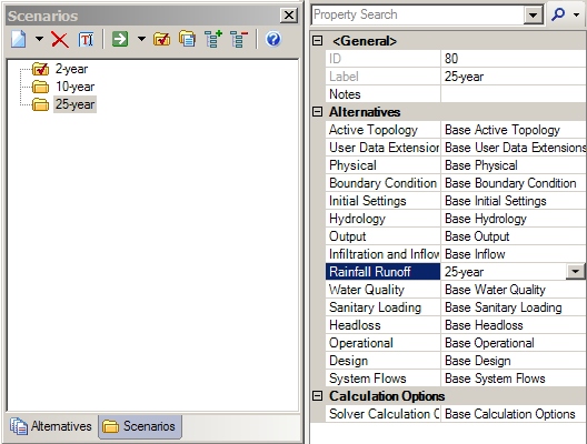

11)      At the top of the Scenario manager, click the New button, choose New Base scenario, and name it according to the next return event.
12)      Double click the new scenario and select the corresponding rainfall runoff alternative
13)      Repeat steps 11 and 12 for all remaining return events.
14)      Notice which scenario has a red check mark next to it (2-year in the above screenshot). If you compute the model now with the green compute button, it will compute catchment runoff with the 2-year time-depth curve. If you would like to compute the model with a different return event, either select it in the dropdown at the top-left corner of CivilStorm or right click the scenario in the scenario manager and choose “make current”.

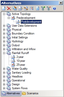

2)      Expand Activate Topology, which will only contain a base alternative by default. This alternative controls which elements are turned on or off. Elements that are inactive are ignored and can be set to disappear.
3)      Name the base alternative as Predevelopment
4)      Right click the predevelopment active topology alternative and choose New > Child. This will create a copy of the base alternative that initially has the same exact settings. As with all alternative types, if you change a setting (in this case whether an element is active or not) in the child alternative, it becomes “local” to that alternative (for that element) and no longer inherits the setting from the base. Settings from all other elements that have not been changed in the child will continue to inherit from the base.
5)      Name the child alternative Postdevelopment (or something similar)

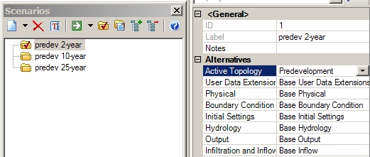

6)      Navigate to the scenario manager. If you already have scenarios set up for return events, change their name to designate them as predevelopment. Notice in the properties of each scenario that they are using the predevelopment active topology alternative, formally labeled as Base. Note: at this point it is assumed that the predevelopment conditions have been laid out in the model. For example you may simply have some catchments going to an outfall or through a channel and then an outfall.

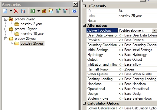

7)      Right click the first return event scenario, choose New > Child – label it as postdevelopment
8)      Open the properties of the postdevelopment scenario. Notice since it was created as a child, it initially inherits all the alternative assignments from the parent predevelopment scenario. Change the active topology alternative to Postdevelopment. You do not have to change the rainfall runoff alternative because it was inherited from the base scenario.
9)      Repeat steps 7-8 for each return event.
