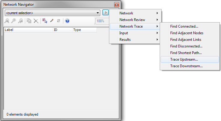

How do I select all elements upstream or downstream of a certain point?
Steps to Resolve
  1. Go to View > Network Navigator
  2. Click on the > button
  3. Select Network Trace and then choose either downstream of upstream
  4. Select the element from which to trace from and click OK
  5. Use the Select in Drawing or Highlight buttons at the top of Network Navigator to view the path in the drawing.
Note: for WaterCAD, WaterGEMS and HAMMER, if multiple sources (reservoirs or tanks) supply flow to the selected element, the path to both will be selected.
