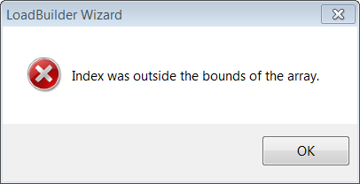

Index was outside the bounds of the array error in the Thiessen polygon creator tool or Loadbuilder

When I try to use a particular shapefile in the Thiessen Polygon Creator tool or in Loadbuilder I get an 'Index Out Of Range Exception' error that says: " Index was outside the bounds of the array." Why is this?
Reason 1 (Version 08.11.03.17 and Earlier)
This message is usually due to the fact that the shapefile is a ZM, Z, or M shapefile. This indicates that the shapefile has 3 dimensions instead of the normal 2 dimesions of a regular shapefile. The 3rd dimension being height or elevation, hence the ZM, Z, or M.
Download the latest version of the WaterCAD or WaterGEMS software
Click here for download instructions
This issue was resolved in a patch set for version 08.11.03.19, so downloading this version or a newer version elminates the issue.
Or you have the option of speaking to your GIS professional and have them remove the ZM, Z, or M from your shapefile

Make sure that the folder containing the SHP file also contains the associated SHX and DBF files with the identical file names.
