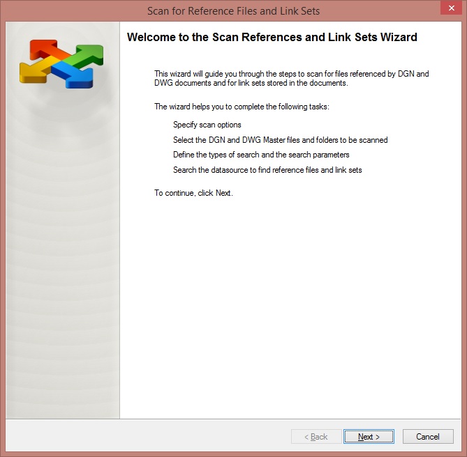

To link the files as a link set, open ProjectWise Explorer and select Tools > Scan References and Link Sets. This will open the Scan References and Link Sets Wizard:
Click Next, then Click Next again.

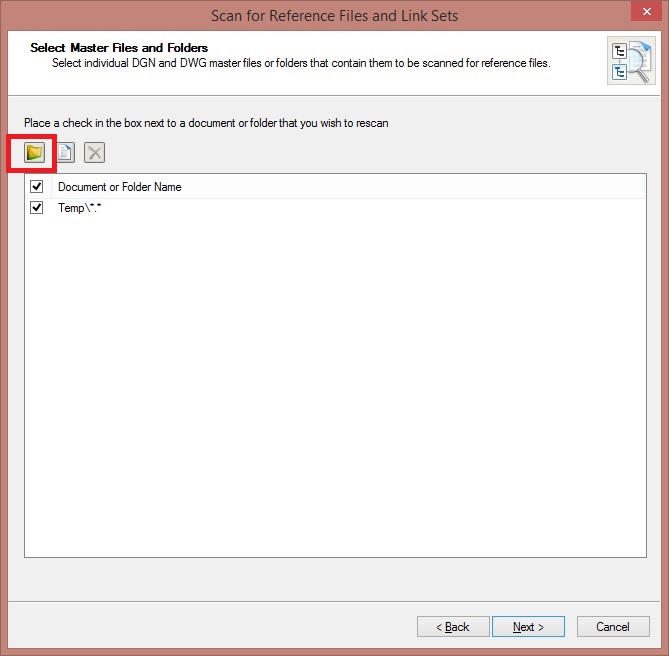

In the Select Master Files and Folders page, click the Select Folder icon in the upper left, then choose the folder where the shapefiles are located.

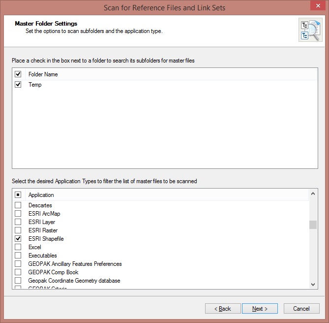

Click Next. In the Master Folder Settings page, put a checkmark next to the folder name where the shapefiles are stored. In the bottom part of the dialog, select the "ESRI Shapefile" application type.
