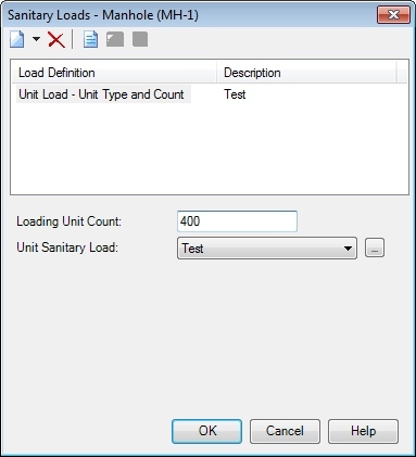

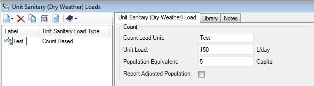

2) Unit count vs population - Keep in mind that the base load is equal to the Loading Unit Count (entered in the manhole properties) times the Unit Load flow rate (entered in the Unit Sanitary Loads dialog). The population is tracked separately to determine the extreme flow factor that will be applied to the total

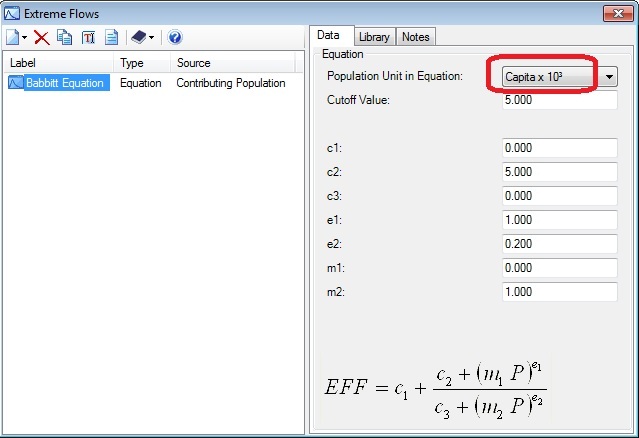

4) Population Units - Be mindful of the unit used in the extreme flow equation's "Population Unit in Equation". Some Extreme Flow equations such as the Babbitt equation use "Capita X 10^3" for the unit, which essentially means that you need to divide the population "P" in the equation by 1000.
5) "Cutoff Value" - If you are using a Extreme Flow Equation type make sure to proper input a value to the "Cutoff Value" field. As explained here the Extreme Flow Cutoff should be > 0. The Cutoff Value is the maximum possible extreme flow factor (EFF) for peaking methods. This is used to prevent unrealistically high values for small populations or land areas.

Loading Unit count - 400
Associated Unit load flow - 150 L/d
Population Equivalent - 5 capita
Extreme flow Method: Babbitt Equation
Population Unit in Equation: Capita X 10^3

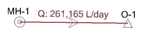

Proof:
EFF = (5+(0*P^1)/((1*(P/1000))^0.2)
EFF = (5+(0*2000^1)/((2000/1000^0.2)
EFF = (5+0)/(2^0.2)
EFF = (5+0)/(1.1487)
EFF = 4.353

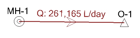

Q = 4.353 X (400 X 150) = 261,165 L/d
Note that the division by 1000 in bold above is due to the Population Unit in Equation of Capita X 10^3
