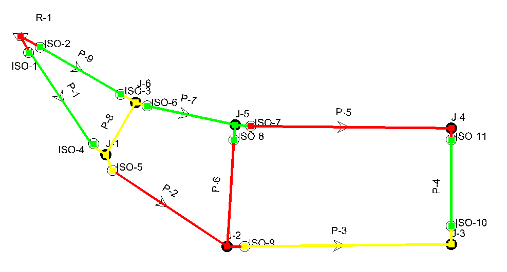

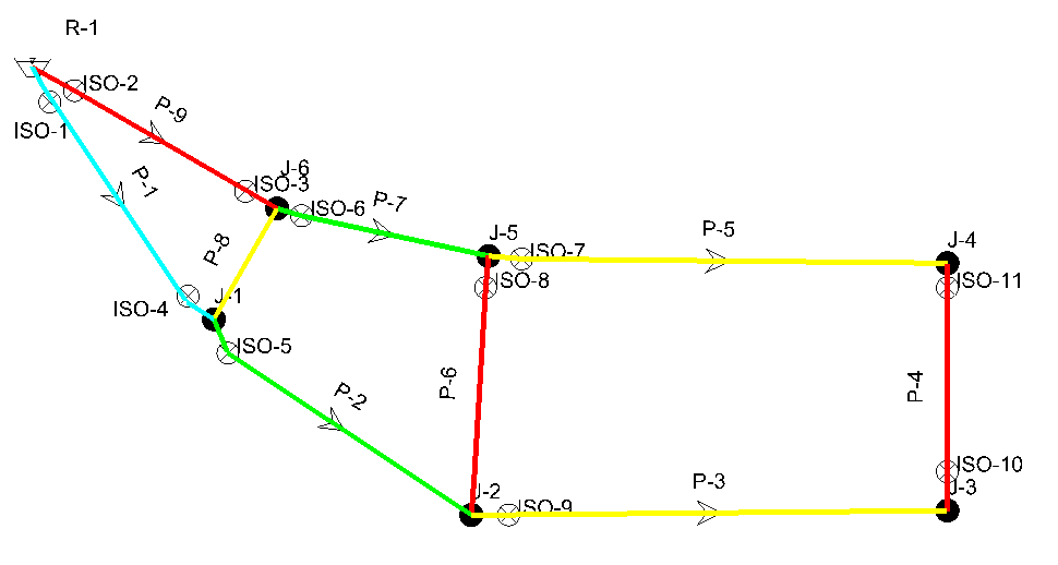

If the criticality analysis has the option "Consider Valves?" disabled, then each segment consists of one and only one pipe as shown below.
If the "Consider Valves?" option is enabled, then the segments (identified by color) are created based on valves that can be closed. The segments are identified by color in the figure below. Note that the various colors assigned to elements by the program are not representative of any network attribute, but are only used to differentiate adjacent segments.

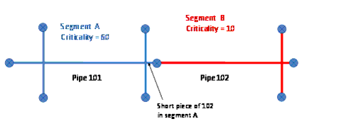

In the figure below, there are two segments that overlap pipe 102-a short one and a long one.

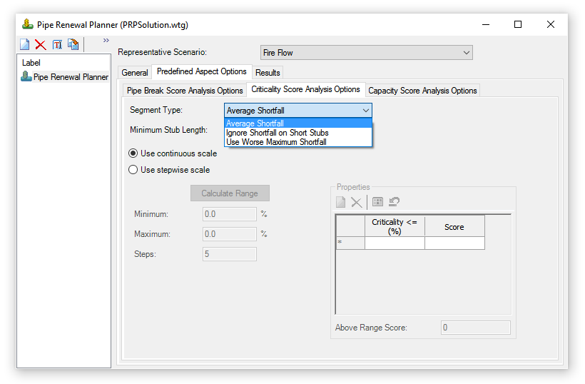

The Pipe Renewal Planner tool provides the following ways to handle pipes with multiple segments:
  1. Use the average shortfall weighted by the length of each segment (default)
  2. Ignore small segments below a certain size (called minimum stub length)
  3. Use the shortfall corresponding to the worst segment in the pipe
For the example above, suppose pipe 102 is 200 ft long and 195 ft are in Segment B (criticality = 10) while the remaining 5 ft are in segment A (criticality = 60). Depending on the option selected, the corresponding scores would be:
  1. (195/200)10 + (5/200)60 = 11.25
  2. 10 (if minimum stub length is greater than 5 ft)
  3. 60
