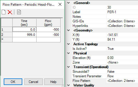

Target Flow VSP: In the case of a Constant Flow (target flow) VSP, morph the pump node into a Periodic Head-flow element. In the properties of the Periodic Head-flow element, choose "false" for "Sinusoidal?", select Flow as the Transient Parameter, then open the Flow Pattern collection. For a constant flow, define two rows, one for time zero and the other for a time greater than the simulation duration. Enter the desired constant flow for both rows, with a negative sign (inflow).
You'll need to use your own judgment to decide of the hydraulics of the pump and upstream network may still have an effect on the transient results (in other words, if it's OK to assume a boundary element).
