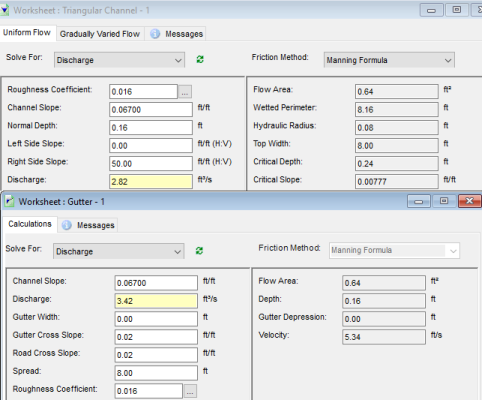

Computed results (such as Discharge) are different between a Triangular Channel and Gutter worksheet, with equivalent configuration.

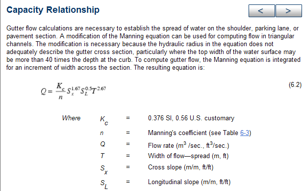

Although both worksheets solve the Manning equation, a modification is applied with gutters, due to how the top width of flow is so much greater than the depth. See equations 6.2 and 5.25 in the Help to compare:

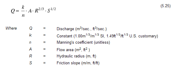

Equation 5.25, Manning Equation:
Equation 6.2, Mannings Equation for triangular gutters:
