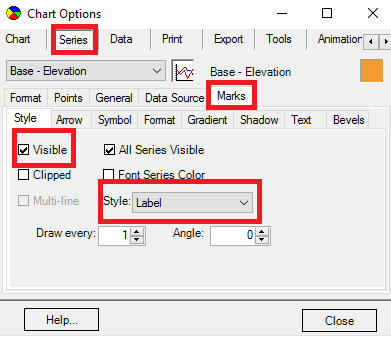

How can I show node labels in a profile, instead of elevations?
Problem ID#: 44493
Right click in the middle of the profile and choose "chart options".
Navigate to Series > Marks > Style. In the "style" dropdown, choose
"label", then make sure the "visible" check box is checked.
