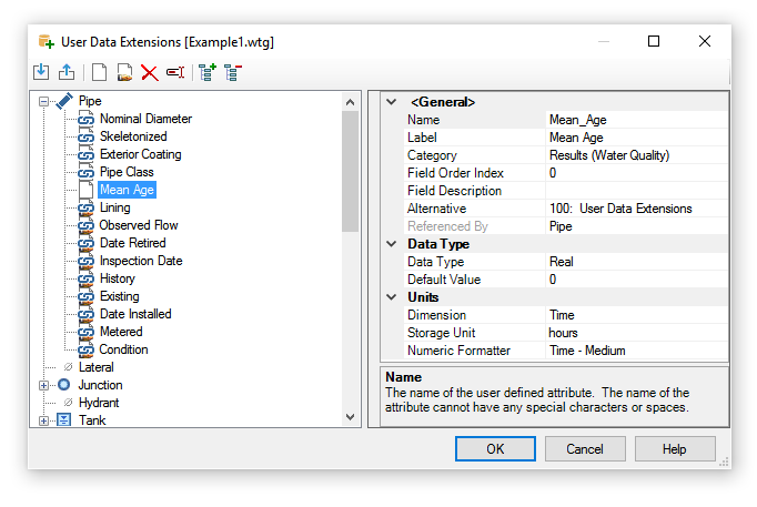

1. Create a User Data Extension for the value the Post-Calculation Processor will calculate.
Note: Keep the Alternative field set to User Data Extensions.

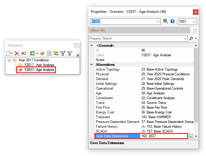

3. Set each scenario to use the corresponding User Data Extension alternative.

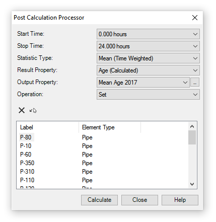

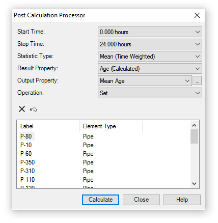

5. Run post calculation processor for each scenario.

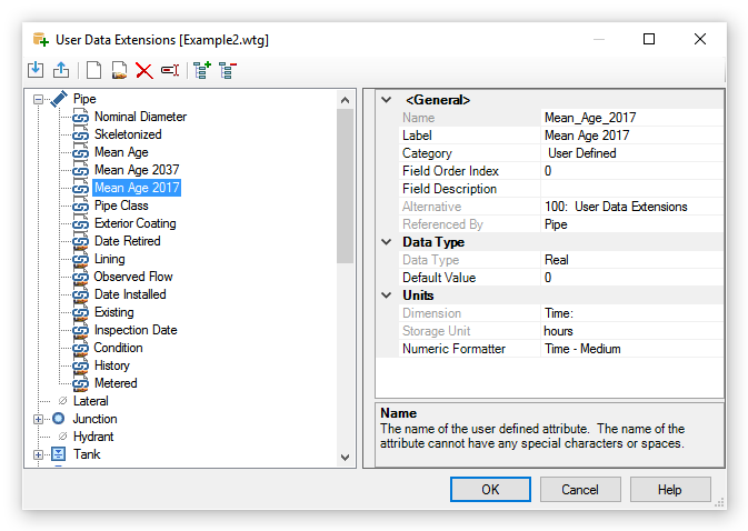

Option 2
1. Create a User Data Extension for each scenario. Keep the Alternative field set to User Data Extensions.
2. Batch compute the scenarios.
See: Scenario and Alternative Management
3. Run post calculation processor for the first scenario with its corresponding Output Property Selected. Repeat for other scenarios and their corresponding Output Properties.
See:

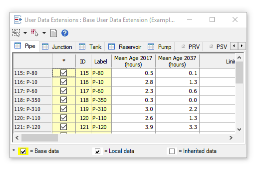

4. Open the user data extension alternative to see results for both scenarios
