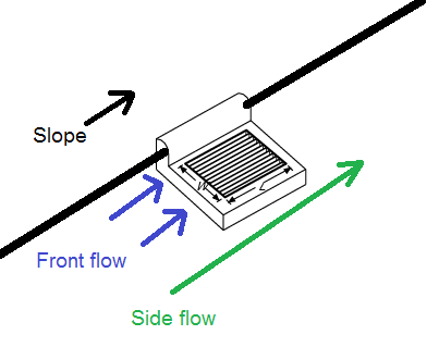

If you select True for "Neglect side flow?", only frontal views will be included in the inlet calculations. Frontal flow is the portion of flow that is in the gutter within the width of the grate. Side flow is the portion of flow on the pavement that is not within the width of the grate.
