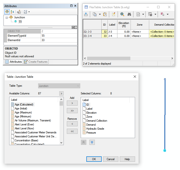

The full list of available attributes for an element type can be found by opening the FlexTable for the element type and selecting the Edit button.
The list of attributes for each element depends on the version of the Bentley Hydraulic and Hydrology application being used. There are a many available attributes, not all of which are required.
The demand for a junction is nested within the demand collection so it can’t be imported directly to the node.
Here is an example list of the properties associated with each model element type.
These properties can be mapped to using ModelBuilder to match the data model you want to use in ArcGIS.
