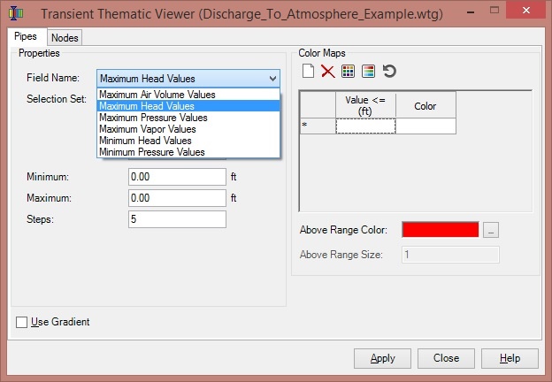

What is the Transient Thematic Viewer and how does it work?
The Transient Thematic Viewer is similar to Element Symbology in that it allows you to color code select HAMMER results for your model.
The results that are color coded are minimum and maximum values. The Transient Thematic Viewer must be active in order to view this information. It is possible to minimize the Transient Thematic Viewer to get a full look at the results that are color coded.
