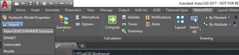

1. Open the AutoCAD platform (eg. "WaterCAD for AutoCAD..." shortcut, for WaterCAD). A blank drawing should open.
2. Select the menu item corresponding to the product you're using (eg. "WaterCAD" menu for WaterCAD).
3. Select Import > Hydraulic Model (or Project on older versions) > Import > [Product Name] Database.
4. Browse to and open the model with extension .SQLITE or .MDB. If the existing model was created in a much older version, such as WaterCAD 5.0, it may need to be upgraded to a more recent version of Standalone first, before the MDB or SQLITE file will be available.
