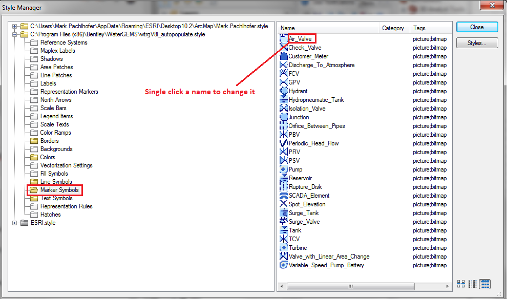

How do I automatically get my layers in ArcMap to display the element style or symbology like in standalone version?
If you want to add the symbology and populate the Layer Symbology, use the following steps:
Open WaterGEMS or SewerGEMS for ArcMap. From the ArcMap toolbar click Customize > Style Manager... In the Style Manager window click the 'Styles...' button on the upper right hand side. This will open the Style References window.
In the Style References window click the 'Add Style to List...' button and browse to the location that you saved the style file in step 2 and then click the Open button.
After that click the "Set as Default List" button on the Style References window to add this style to the default list that is populated when opening ArcMap. Next hit the OK button to close the Style References window.
Finally click the "Close" button to close the Style Manager window.
Now when you go to add in a new or existing SewerGEMS projects all the SewerGEMS symbology will automatically come in when the layers are added to the table of contents.

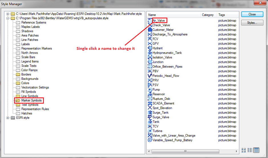

** If you wanted to only bring in a few icon for the SewerGEMS layers (eg. just the pipes, junctions, pumps, and tanks) you could locate the newly added style in the Style manager window and click the "+" plus sign next to it. This expands the items that make up the style. Next click on the 'Marker Symbols' folder which opens the symbol names and their icons on the right side of the window. The last step is to add an underscore 1  "_1" to the end of the name for the element. Then click the close button. The next time you add an existing model or a new model that layers (elements) symbol we result to the default symbol. See the screen shot below. **
