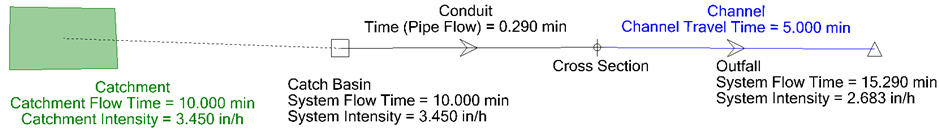

For example, look at the following images.
At the cross section:
System flow time = (catchment flow time) + (conduit flow time)
System flow time = 10.000 min + 0.290 min
System flow time = 10.290 min
System intensity = 3.407 in/hr
At the outfall:
System flow time = (catchment flow time) + (conduit flow time) + (channel flow time)
System flow time = 10.000 min + 0.290 min + 5.000 min
System flow time = 15.290 min
System intensity = 2.683 in/hr

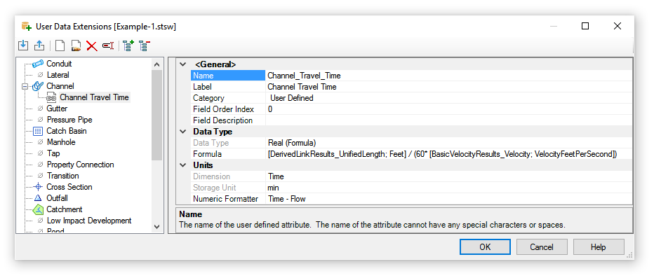

The channel element does not contain a property that reports the travel time through the channel. This field can be added by creating a formula user data extension. The process of doing this is explained in this article, however the following image gives a general idea of how it would be configured.
