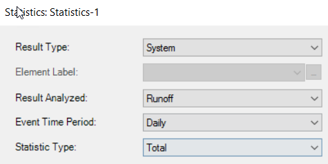

Can I view the total runoff volume from each catchment for certain time frames, such as each day of a simulation?
Using the Statistics tool (under the Analysis menu) with the Explicit (SWMM) calculation engine, you can see the total system runoff volume, by selecting:

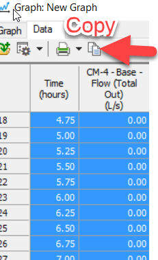

If you must see this information on a per-catchment basis, the only other option at this time would be,
