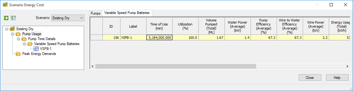

Scenario energy cost "Time of Use" doesn't match calculation options "Duration"
Product(s):SewerGEMS, CivilStorm, SewerCAD
Version(s):10.00.00.45
Area:Calculations

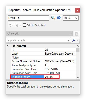

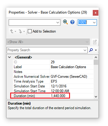

When running a scenario energy cost analysis with a variable speed pump battery (VSPB) the calculated "Time of Use" exceeds the "Duration" in the calculation options dialog.
Download and apply the latest patch set.
