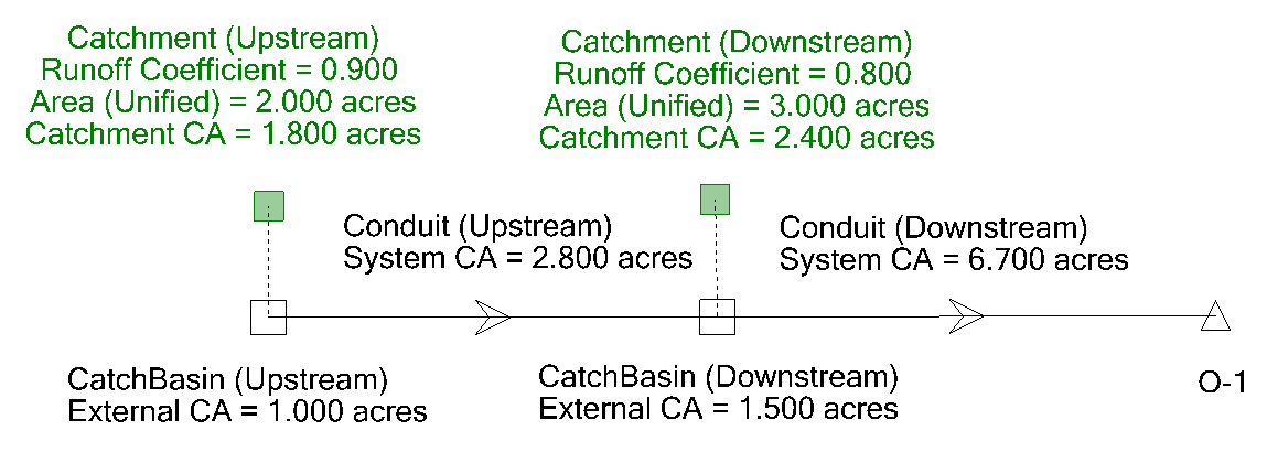

When using the Rational runoff method, the conduit property "System CA" is the sum of the upstream "Catchment CA" and catch basin "External CA" values.
For Example:
Catchment (Upstream)
Runoff Coefficient = 0.9
Area (unified) = 2 acres
Catchment CA = 0.9 * 2 = 1.8 acres
Catch Basin (Upstream)
External CA = 1 acre
Conduit (Upstream)
System CA = Catchment CA + External CA = 1.8 + 1 = 2.8 acres
Catchment (Downstream)
Runoff Coefficient = 0.8
Area (unified) = 3 acres
Catchment CA = 0.8 * 3 acres = 2.4 acres
External CA = 1.5 acres
Conduit (Downstream):
System CA = 1.8 + 1 + 2.4 + 1.5 = 6.7 acres
