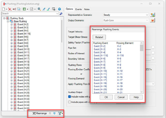

How can I rearrange flushing events? (change the order)
Starting with OpenFlows Water 2026 (26.00.00.XXX and higher) flushing events can be freely rearranged (rather than only being able to "Shift Up" or "Shift Down" one line at a time) as well as the ability to "Relabel" the Event Names.
Click the "Rearrange" button, found in the bottom-left corner of the Flushing manager:
In the "Rearrange Flushing Events" window that appears, you can select one or more events (hold CTRL or shift to multi-select) and drag them to the desired position within the flushing area.
Click "Relabel" to use the same standard relabeling operations found in Flextables (see more in this article). For example you can choose "Renumber", provide a prefix and the program will relabel the events based on the rearranged order.
Note that you cannot undo this once you click Okay and update the order or labels in the Flushing manager.

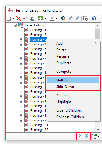

Older versions
In version 08.11.04.XX and 08.11.05.XX, you can right click on the Flushing Event or Flushing Area and choose "Shift-up" or "Shift-down" to change the order.
In 08.11.06.XX and higher, you can also use the shift-up and shift-down buttons at the bottom-left corner of the Flushing dialog:
