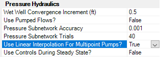

1) If you're using SewerCAD or the GVF-Convex solver in SewerGEMS, use the pump element with a fairly flat pump curve up to it's maximum capacity. This can be done using the multi-point pump curve type, in the pump definition. It is best not to make the curve perfectly flat, in the interest of numerical stability. In the calculation options for the GVF-Convex solver, set the "Use linear interpolation for multipoint pumps?" option to "True".
