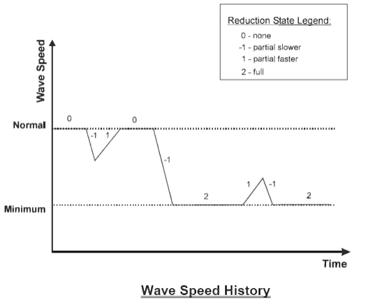

The Wave Speed Reduction Factor calculation option allows you to model the reduction in celerity that occurs at low pressure. Entering a value below 1.0 will result in the following behavior:
Consider the below graph of wave speed for a pipe segment over time:
[0] indicates that the wave speed is at its original value.
[-1] indicates a reduction in wave speed due to pressure falling below zero.
[1] indicates an increase in wave speed due to pressure becoming positive again
[2] indicates that the wave speed has been fully reduced (to the wave speed reduction factor * the original wave speed)
Therefore, the graph indicates that the pressure first dropped below zero, but became positive shortly after, before the wave speed was fully reduced. It then dropped again and remained negative long enough for the wave speed to fully reduce. Next, the pressure became positive again but fell back below zero shortly after, before the wave speed returned to the original value.
For example, consider entering the following data in the model: a wavespeed of 1000m/s , a Wave Speed Reduction Factor of 0.5, a Decrease Time of 0.2 seconds, and an Increase Time of 3 seconds. In this case, if the liquid pressure reaches zero pressure, the wave speed in that pipe will start to reduce. Assuming the pressure doesn't increase again in the meantime, the wavespeed will reduce to 500 m/s (1000 m/s x Wave Speed Reduction Factor) linearly over 0.2 seconds (the Decrease Time).
While the pressure stays negative the wavespeed will stay at 500 m/s, but if the pressure becomes positive the wavespeed will also increase linearly back up to 1000 m/s over 3 seconds (the Increase Time).
