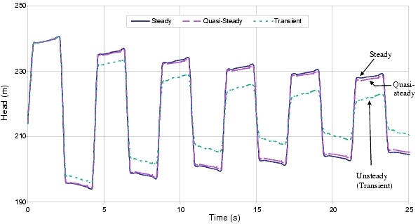

You can try adjusting the Transient Friction Method in the transient calculation options as mentioned in the below article, but that may not necessarily help (and you may notice instability). You might consider simply accepting this behavior. For example if you need to design the system based on the max or min pressure, you may already have the information you need to proceed.
"Unsteady" vs. "Unsteady - Vitkovsky" transient friction methods in HAMMER
