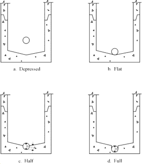

This notification means that the inverts of the pipes at the manhole do not make sense for the selected benching type. For example, say you have the manhole benching method set to "flat". This assumes that the downstream pipe invert should be equal to the manhole invert. If they're not, you'll get that user notification that should suggest that you either need to correct the pipe/manhole invert or use the correct benching method.
In another example, say you have the benching method set to "depressed". In this case, the downstream invert is assumed to be above the manhole invert.
In the diagram below, which is from the help document titled "Correction for Benching", you can see what each benching method looks like:
Note that the benching method is selected in the node (manhole, catch basin) properties, when using the HEC-22 structure loss method.
