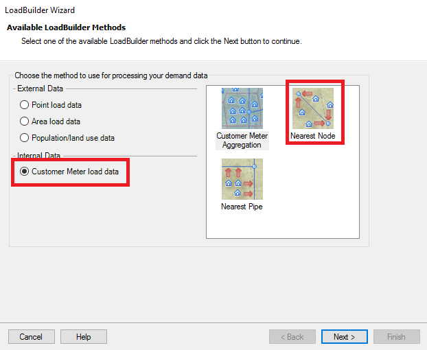

Workaround
The workaround is to use the following steps to assign the customer meters to the nearest node element (junction, hydrant) in bulk:
1) Open Loadbuilder and create a new Loadbuilder run
2) Choose the option at the bottom of the first window to where it states "Customer Meter load data" and choose the Nearest Node method located on the right side of the window.
3) Choose the node layer as a selection set the users have if they only want to assign the meters to certain nodes or choose "Junction/All Elements".
4) Choose the Customer Meter Layer "Customer Meter/All Elements" and keep the check box unchecked for "exclude unconnected Customer Meters that already have a valid Associated Element".
5) Choose to update the existing alternative and select the alternative name. Add a Label to name the Loadbuilder run.
Note: you may need to review the results of this update to ensure that customer meter connections are acceptable.
