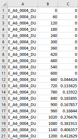

2. The hydrograph data needs to be in the correct format ("<element label>,<time>,<flow>") and then saved to a Comma Separated Values (.csv) file type. Make sure to close the .csv file before proceeding.

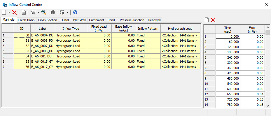

3. The units used for the import are assumed to be the same as defined for "Time_Extended" and "Flow" in the hydraulic models unit options. Go to Tools > Options > Units and set the units "Time_Extended" and "Flow" to match the units used in the .csv file.
4. Import the data by going to Components > Loading > Inflow Control Center. Click the new icon and select "Import Hydrographs" from the drop-down list. Navigate to and select the .csv file, then click open. The hydrographs should be populated in the Inflow Control Center.
