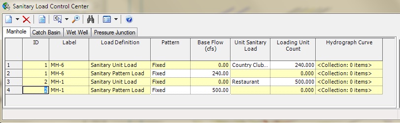

For a case where the value being imported is a count of population, you can try the following after importing through loadbuilder. Open the Sanitary Load Control Center, initialize unit loads for all elements using the first icon, then copy the base flow value into the Loading Unit Count field, and populate the Unit Sanitary load (the type). The pattern load should then be deleted from the Sanitary Load Control Center if it is not to be included in the calculation. The screenshot below is what the Sanitary Load Control Center may look like after updating the model with LoadBuilder and copying the data in the Load Unit Count field, but before deleting the pattern loads.
