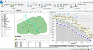

In storm-sewer products, there are two kinds of graphical displays: profiles and graphs (charts). Profiles show cross sections of the network to scale along some path through the network and are described in the Using Profiles section of the v8i Help.

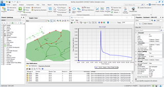

Graphs are plots of some attribute or group of attributes vs. time at one or more elements. Profiles and graphs can only be drawn for results of model runs; in order to view a graph or profile, you must first successfully compute your model (run the model successfully).
For details on how create a graph, see the Creating a Graph section of the SewerGEMS or CivilStorm Help. Bentley SewerGEMS and CivilStorm contain a powerful graph editing tool to help you customize your graphs.
For more information about this tool, see the Graph Dialog Box section of the respective Help within SewerGEMS or CivilStorm.
