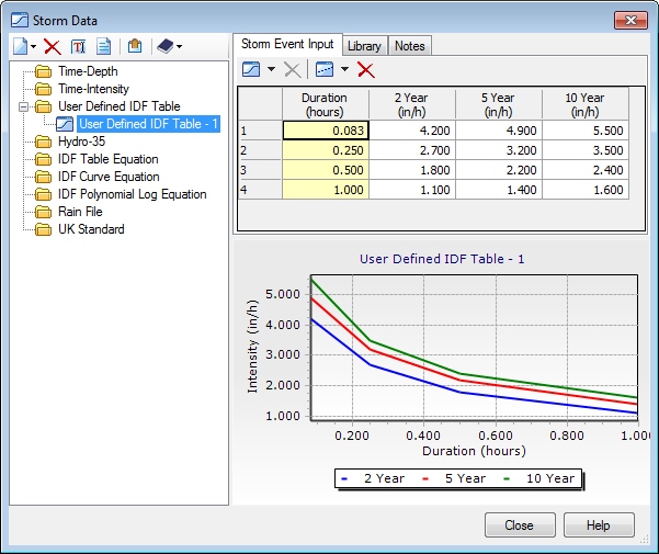

Here is the resulting IDF storm event group:
1) Setup your data in the format above.
2) Create a new user defined IDF table
3) Click the import button
4) Choose the file and click
