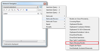

To find pipes without end nodes using Network Navigator:
  1. Open Network Navigator from the View menu.
  2. Click the ">" box, expand Network Review, then select Pipes Missing Nodes.
  3. Click execute in the Network Navigator dialog.
This should populate the pipes which are missing end nodes and might be missing end nodes.  If for some reason Navigator doesn’t populate these pipes which are missing end nodes then,
  1. Go to pipe flex table>Right click on Start node column>Sort Ascending.
  2. This will populate the pipes which are not having end nodes so start node should be blank. Zoom to that pipe, Right click in the drawing>Delete.
  3. Repeat same for stop node if required.

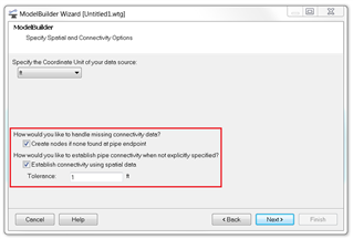

However, to avoid this, you should use the establish pipe connectivity feature of Modelbuilder . You can choose to have a node created when there isn't one found at a pipe endpoint. You can also have pipe end points connect to nodes that are within a distance/tolerance you define.
