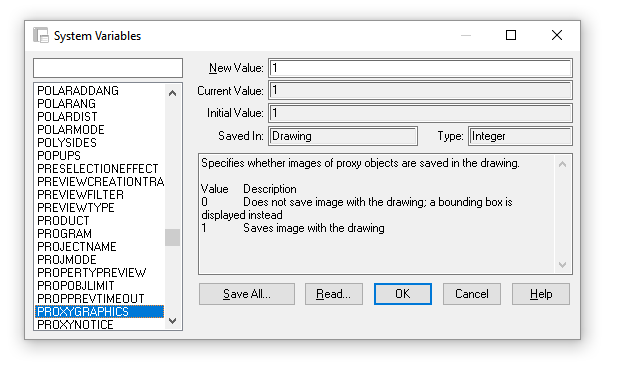

1. Open AutoCAD with the Bentley Haestad product integrated
2. Enter the command: SYSVDLG
3. Set the following System Variables
PROXYSHOW = 1
PROXYGRAPHICS = 1
4. Click OK
5. Save
The elements should appear correctly in AutoCAD with or without the Bentley Haestad product integrated.
System variables in AutoCAD
