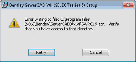

Installation "Error writing to file...Verify that you have access to that directory"
Product(s):WaterGEMS, WaterCAD, HAMMER, SewerGEMS, StormCAD, SewerCAD, CivilStorm
Version(s):08.11.XX.XX and 10.XX.XX.XX
Area:Installation
When attempting to install Bentley Hydraulic and Hydrology software, the following error appears:
"Error writing to file...Verify that you have access to that directory."
Solution 1
Verify you have permission to write to the directory listed in the error dialog.
An easy way to check this:
  1. Navigate to the directory.
  2. Right-click and select New then select Text Document.
  3. If you can save the text file without error then you should have permission to write to the directory.
Solution 2
Disable anti-virus software while installing the hydraulic and hydrology software. If necessary, request permission from your IT department before doing this. For assistance with disabling anti-virus software contact the company that created it.
