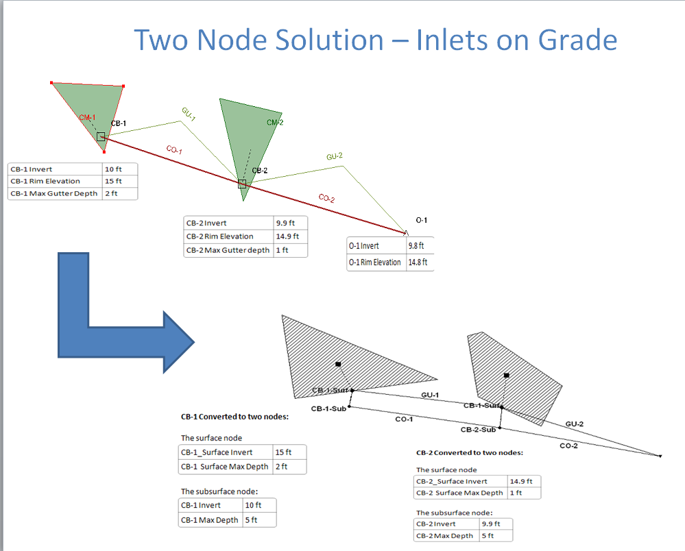

Can SewerGEMS be used to model backflow through a catch basin and into a gutter? In other words, can the flow from a catch basin vault back up and overflow into the gutter, pass downstream and approach the next inlet?
[Problem ID#: 89471]
This can be modeled in SewerGEMS and CivilStorm V8i SELECTseries 3 (or higher) using the Explicit (SWMM) solver. This method is internally referred to as the Two Node Solution.
This case is used in the following inlet types:
If you look at the below screenshot, this shows a typical setup for an On Grade inlet. The catch basins are connected by a conduit and a gutter. When the SWMM solver is used, it is assumed to be like in the image at the bottom, where the solver will split the catch basin into two nodes, with subsurface and surface flow. Such a setup could allow for backflow in the catch basin to be picked up by the gutter and propagated downstream.
